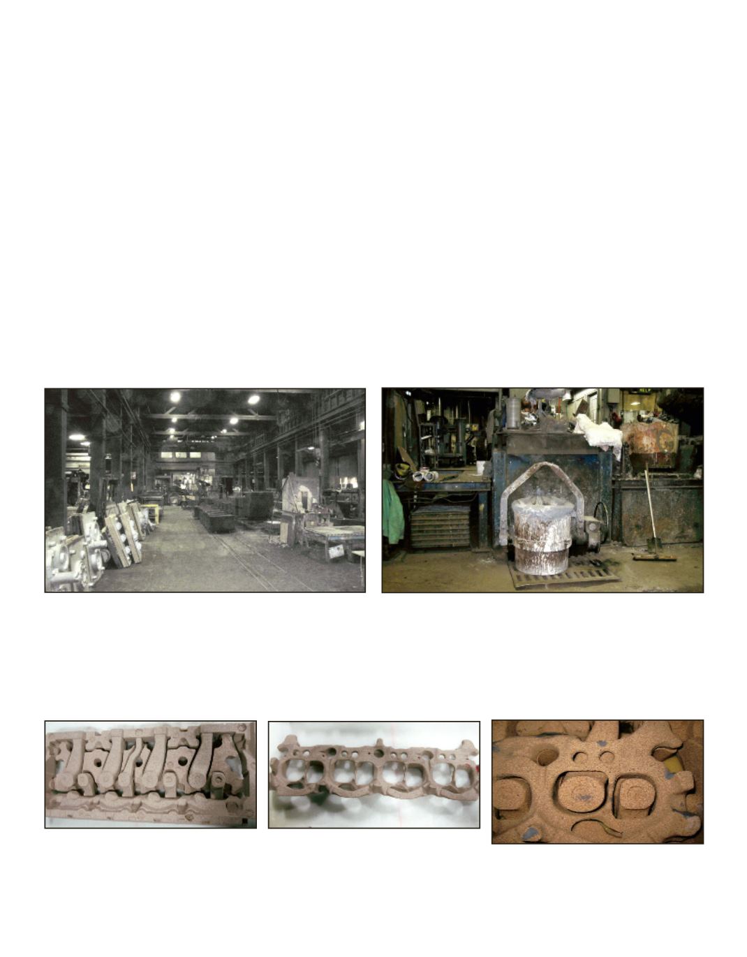

The foundry production floor where the molds are poured.
Fifty years ago there were cast iron foundries in every
large city in this country. Today, due to strict Department
of Environmental Protection regulations, most of the
smaller and medium-sized cast iron foundries have been
put out of business. Larger foundries remain but they rely
on large production runs. Most foundry business is now in
Mexico or China.
The crucible is where the cast iron is heated to 2650°. The
molten metal is ladled or poured into the mold where it
fills all of the cavities and hollow spaces. Air, excess sand
and impurities are forced out of the mold. After the casting
has cooled the mold is disassembled, revealing the fin-
ished casting. Before it can be machined unnecessary
pieces are broken off and flashings ground off.
Cores within the mold create cavi-
ties – water jackets, intake and ex-
haust ports, combustion chambers and
oil drain holes.
Detail of the core around the intake
and exhaust areas.
The water jacket core creates the cav-
ities around the combustion chambers
and valve ports.
