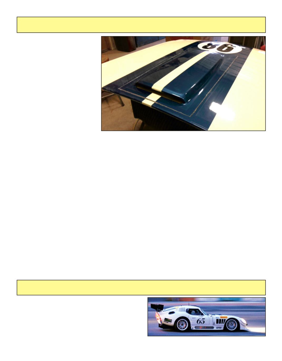

A correct “backwards” hood scoop
has now been incorporated on one of
the two “new” Jim Marietta-built pro-
totype GT350R2s being developed by
Jim’s Original Venice Crew. Further
track tests should soon confirm the va-
lidity of the idea.
Other originally rejected (because
of cost) ideas on the new Marietta
GT350R2 Mustangs, like Ford de-
signer Klaus Arning’s Independent
Rear Suspension and an entirely new,
aerodynamically-efficient front va-
lence with flexible lower air-dam (also
by Brock) have been track-tested,
showing significantly positive results.
We almost hate to bring this up,
but Chevy started using Brock’s idea,
rejected by Ford, which they called
“cowl induction” in the late 1960s with
their Chevelles. The principle was
eventually incorporated into their Ca-
maros and Corvettes…and even pick-
trucks! Scoops may look cool but cowl
induction works!
