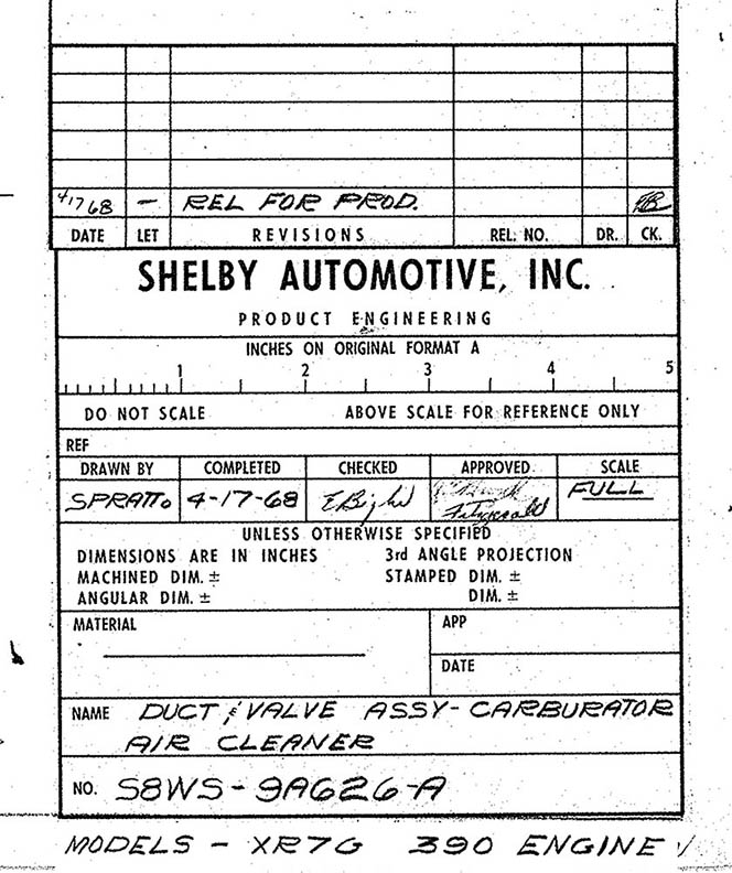

Quote from: Special Ed on February 10, 2024, 07:45:30 AM
The unique KR only snorkle was made from a 68 ford snorkle offset then a 68 black AMC snorkle extension then the 68 ford end that the s-tube connects to the cj heat shield. The  unique KR s-tube was a modified  cj part haveing 3 holes at top and 3 notches on bottom where as regular 68 cj s-tube only had 1 hole at top and 1 notch at bottom. These  KR modified parts were made due to the wider KR alum valve cover vs the regular 68 1/2 cj chrome valve covers.
The non-Hertz 390 equipped XR7-G Cougars also needed a unique snorkel to clear the Shelby Cougar finned aluminum valve covers and it too utilized a '68 AMC snorkel extension.
The technical drawings were created by Shelby Automotive and I guess it was a part of Smith's duties to weld them up and (of course) install them? Wonder why the KR snorkel wasn't used in both applications?
