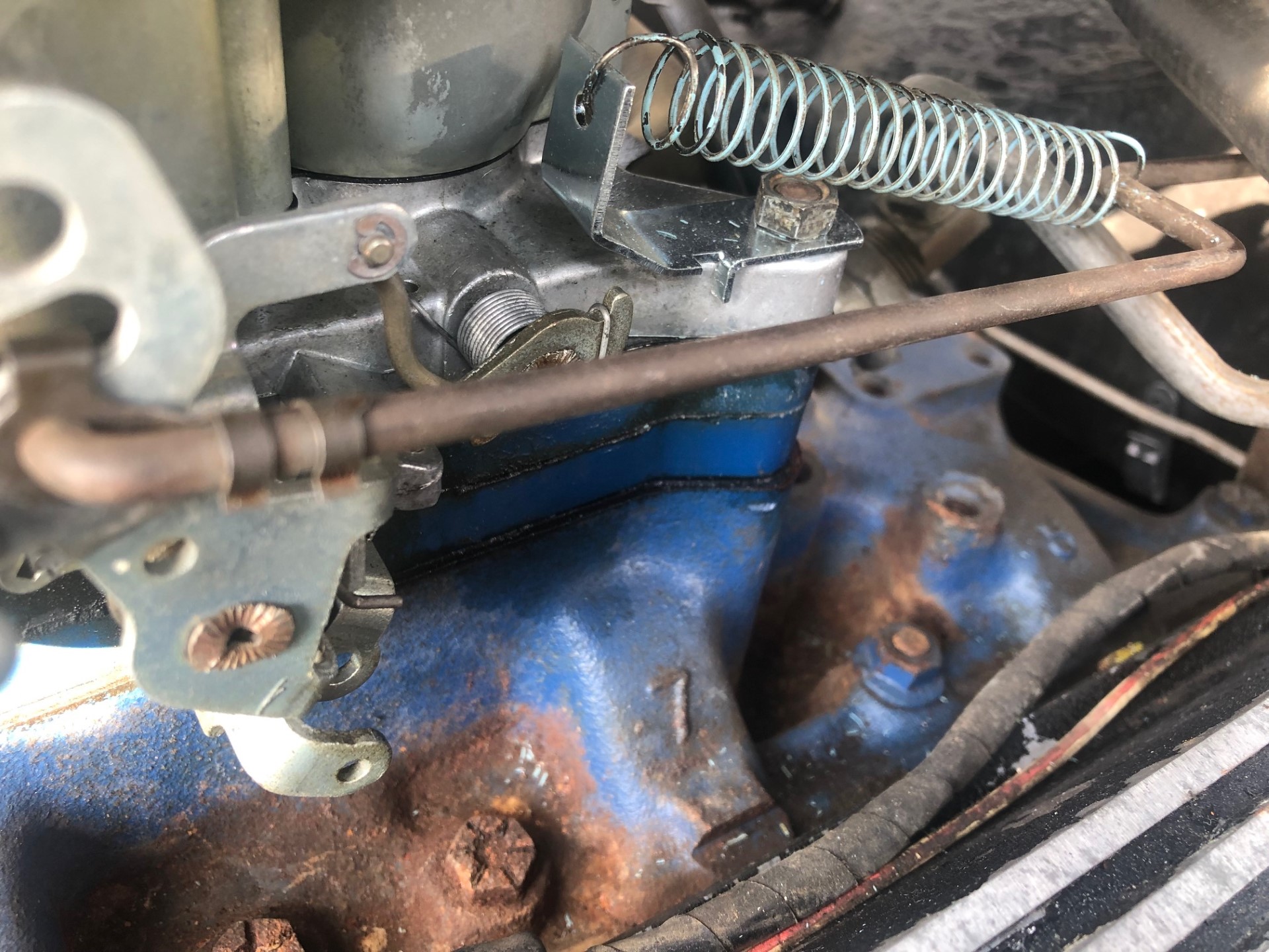

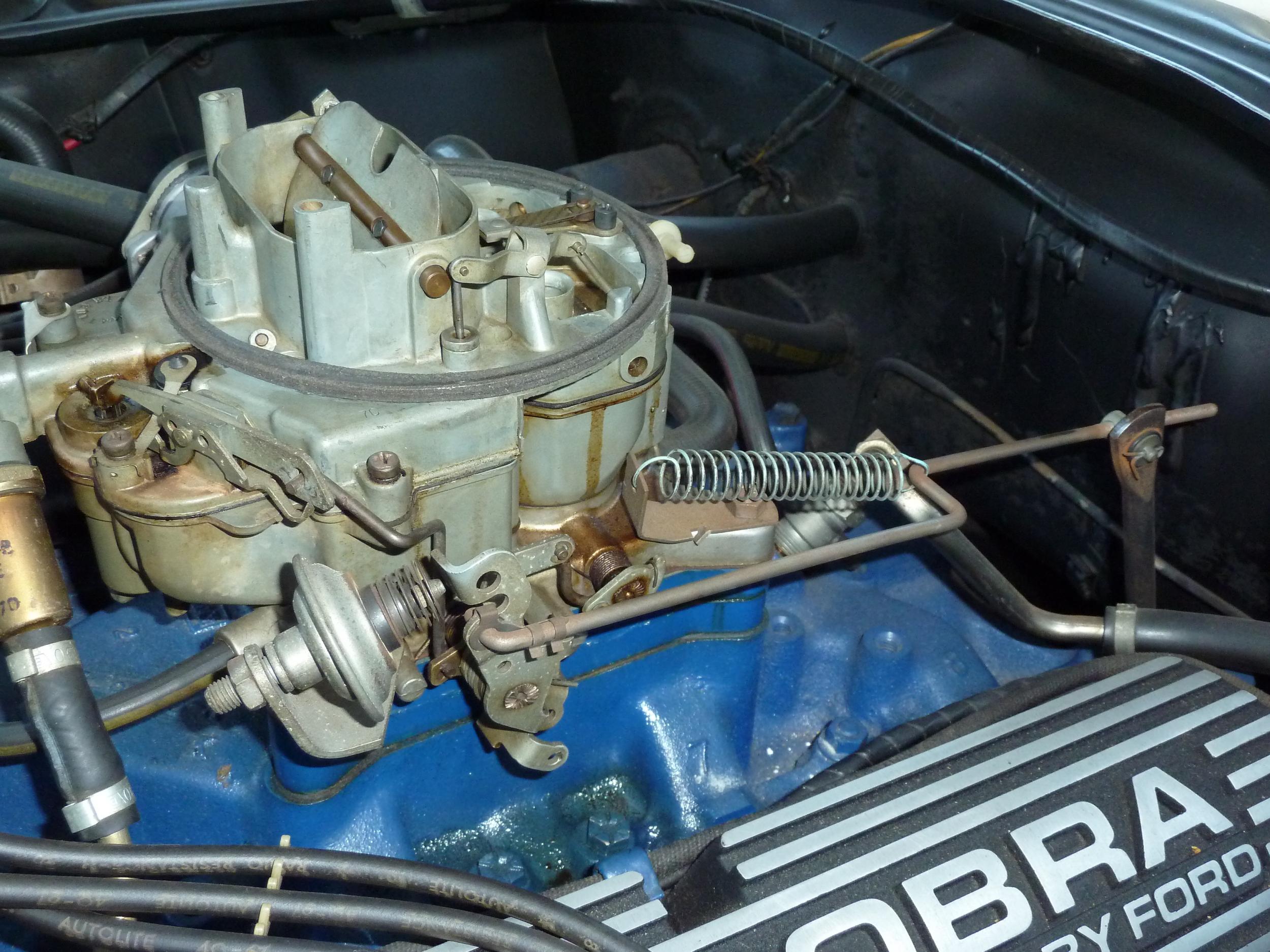

Originally my 68 GT350 had the iron manifold and Autolite carb installed in it when purchased in April 1972.
There were four studs installed in the intake in the center most positions. Two on each side.
The picture posted here of the painted manifold does not agree with what I had.
Whether or not there were variations in production, I can't say. Since I am not limited to just this one engine in my experience, it was my thought that on an iron intake the studs were used and on an aluminum bolts in that position.
It may be that the engine assembly plant found it more reliable to accurately locate the intake gaskets with studs when using the much heavier iron intake. Granted that is speculation on my part but that procedure of using studs to hold the gaskets in place is fairly common place now even in the aftermarket.
The valve cover bolts ON MINE were just zinc plated with no head markings, with matching zinc plated split washers.
As pointed out to me I can't testify in court that I had the original factory configuration simply because I was not there to witness the original assembly. I can't deny that.
