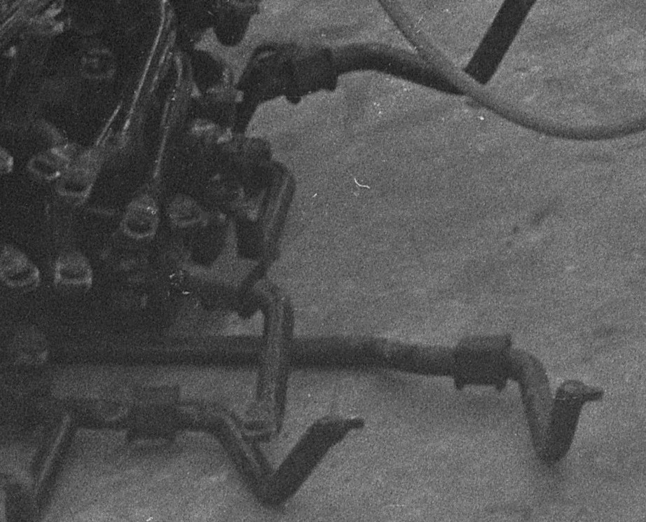

Back to my original post with the image of the stack of sway bars.  I don't agree that those are take-off bars, they look like 1" bars.  And the whole point of posting that is to show that there appears to be a shine to the bars, like they were painted.
The other pic I posted of underside is likely an early prototype, as noting slot screws for the oil pan... I'm not sure that comparing that car to other normal production cars would help what we're discussing.  Maybe it would have been best that I didn't post it.
Where I'm at with all this is:
      -the stock Mustang 65-66 13/16" sway bars were not painted, they were a heat treated dark appearance
      -there may have been 2 suppliers of '65 (or possibly '66) 1" SA sway bars.  Based on the LAX pic, some of the '65 ones may have been painted black (as they do appear to be painted, at least to me)
The pile does not look like it is effectively staged for items ready to be installed on the SA assemblyline. The pile looks typical of a haphazard junk pile of take off parts would have been treated based on other type pictures. I have seen SA pictures of piles take off cast iron intakes and exhaust manifolds stacked up in similar fashion . To me the bars look thinner then 1 inch . The eyelet ends look different and the shiny black paint looks different. That is the reason I have my point of view. If you don't agree with my opinion then lets agree to disagree.
Quote from: Bob Gaines on February 22, 2022, 10:54:22 AM
How do you explain the larger 1" style sway bar to body bushings on them?   That style bushing was never used on the assembly line 13/16" sway bar.
The eyelet ends look exactly like the sway bar on 5S003.

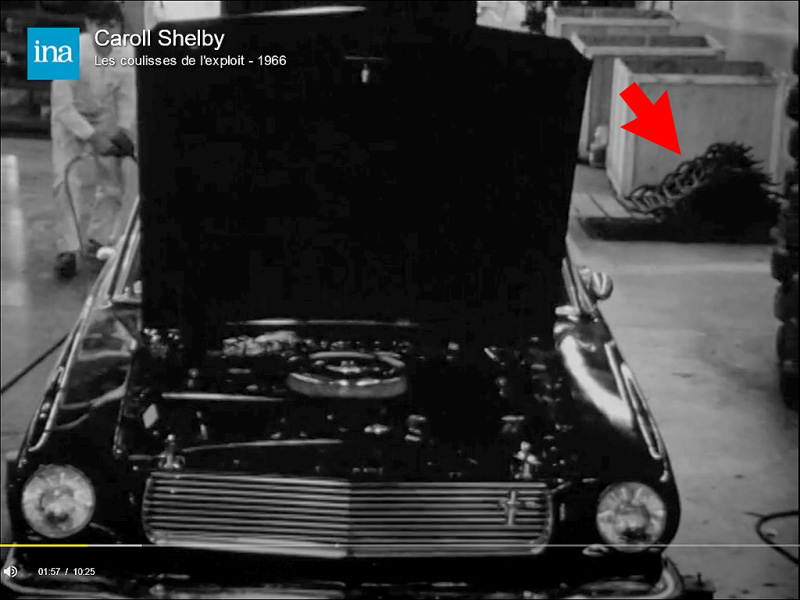

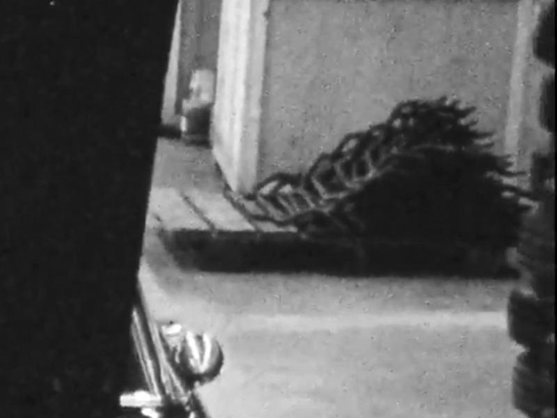

Thanks, was asking because I had not heard anything about 65-66 bars being installed at SJ. The "French Film" shows a pile of bars at SAI in early March 1966, screenshot from the 1:57 mark.....
#23
Quote from: s2ms on February 22, 2022, 06:25:59 PM
Quote from: J_Speegle on February 22, 2022, 05:46:36 PM
Quote from: gt350hr on February 22, 2022, 04:50:18 PM
   I have never seen anything to show they did install them there until '67 when they were on the DSO sheets. If some one has a '66 DSO sheet it would certainly be called out there IF SJ did it on the line.
For 66 production the 1" bars were not installed at San Jose but at Shelby. Interesting part (my opinion) is that the cars were built without sway bars but hardware was included with the cars- Brackets, bolts and end links
That is a example of a neat organized stack. I may be missing it but I don't see any bushings installed on the bars .Unfortunately the resolution is not good enough to make out what the end link eyelet looks like.

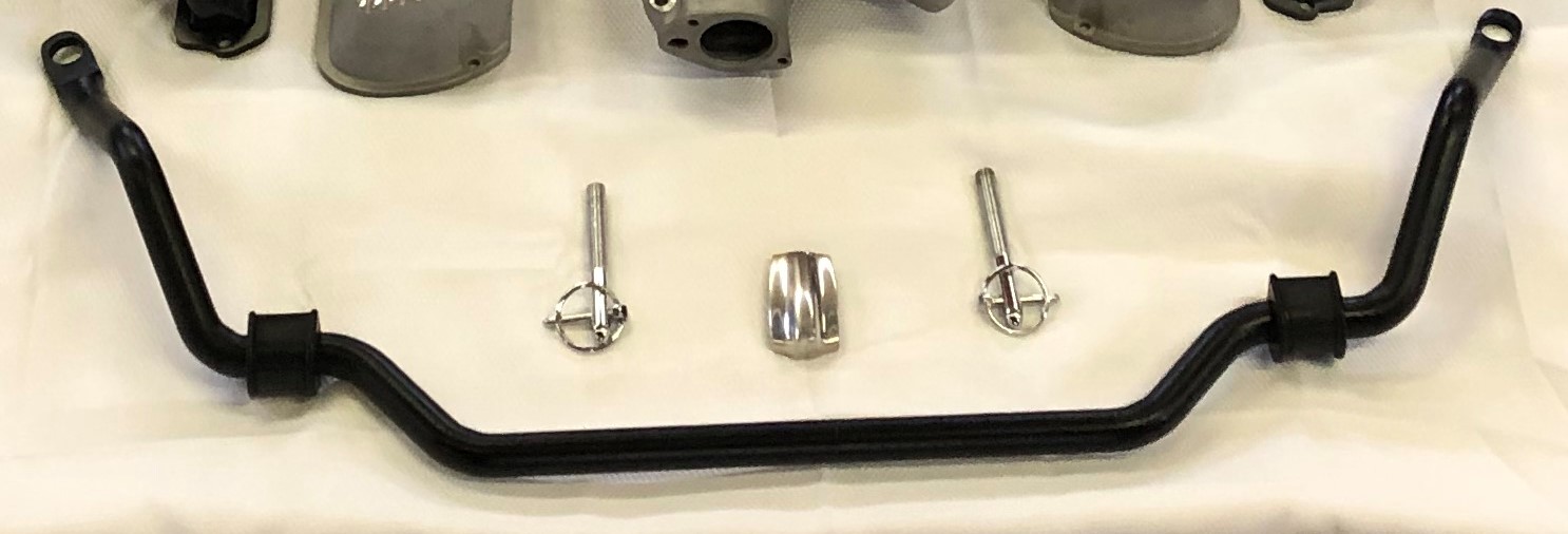

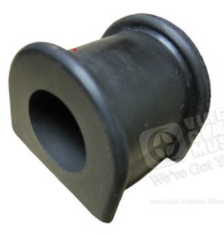

Let's see if I can help explain why I think that pile of sway bars on the floor at LAX are 1" bars...
Below are 3 pics:
The first is the 1" style sway bar to body bushing.  SA sourced Ford for the bushing (C0AA-5493-A) and the bracket (C0DD-5486-A)
Second pic is what the regular Mustang sway bar to body bushing looked like.  Note it did not have the cupped sides like the Shelby bushing.
Last pic is a blow up of the stack of sway bars... there are 4 bushings showing clearly, they all have the cupped sides, which is why I don't think they are Mustang take-off bars.

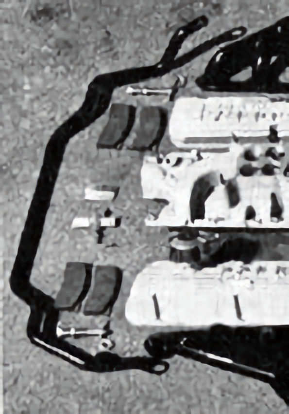

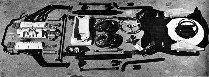

Throwing an additional pic out there for consideration... this is the '65 GT350 parts layout photo, not sure if it was Venice or LAX... most likely LAX.  A close up of the sway bar shows a high reflection like paint.  Unfortunately, I don't have a better resolution.
For at least '65 GT350, my suggestion would be that natural OR painted black were possible.
Original pic:
