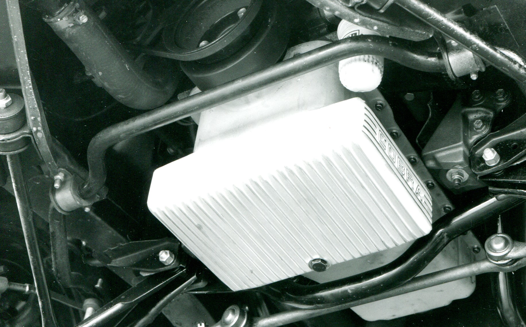

First pic I have is possibly of an early '65 GT350, maybe a prototype.  It is an undercar photo showing the front suspension.  The sway bar looks lighter color than what I've seen on Ford assembly plant sway bars.  It may be an earlier unpainted version?

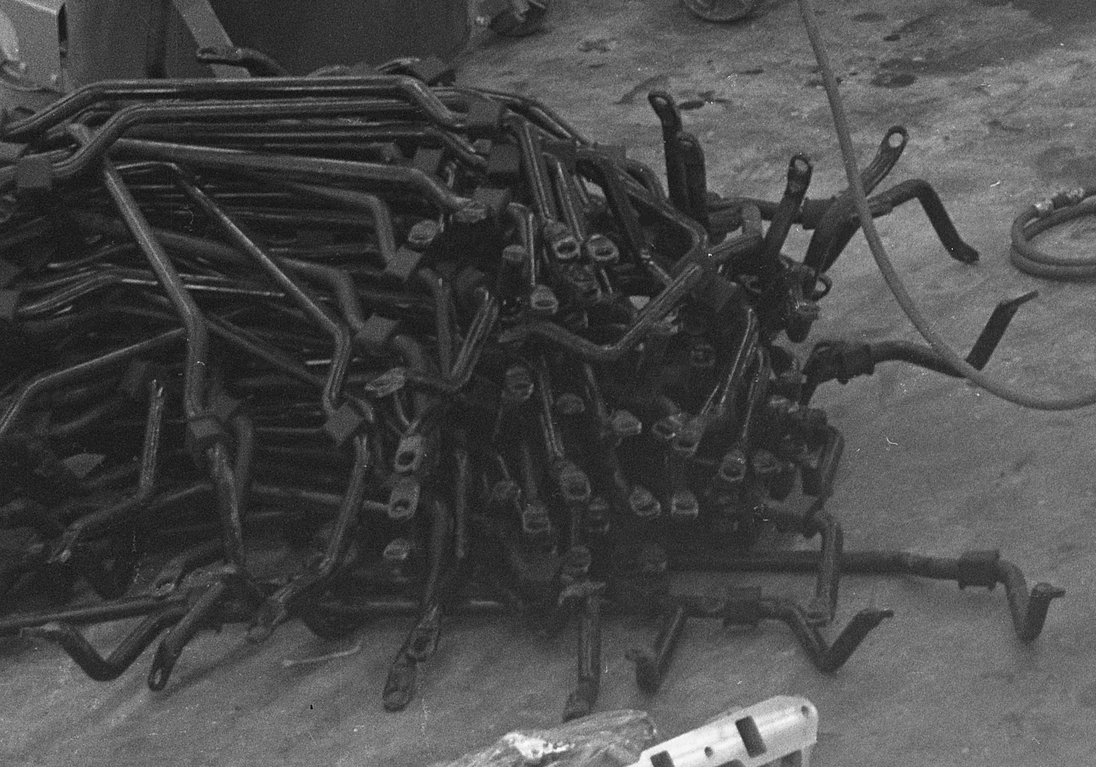

Second pic I have is a high resolution of the pit area at LAX with a big pile of sway bars.  Zooming in on the pic, the bars are all at different angles and have a sheen on them that looks like paint.

So that there is no confusion for others viewing the picture of the stack ,they are of take off factory thinner painted swaybars. The stock bar was taken off and the 1 inch swaybar was added along with different larger size bushings and bushing brackets.

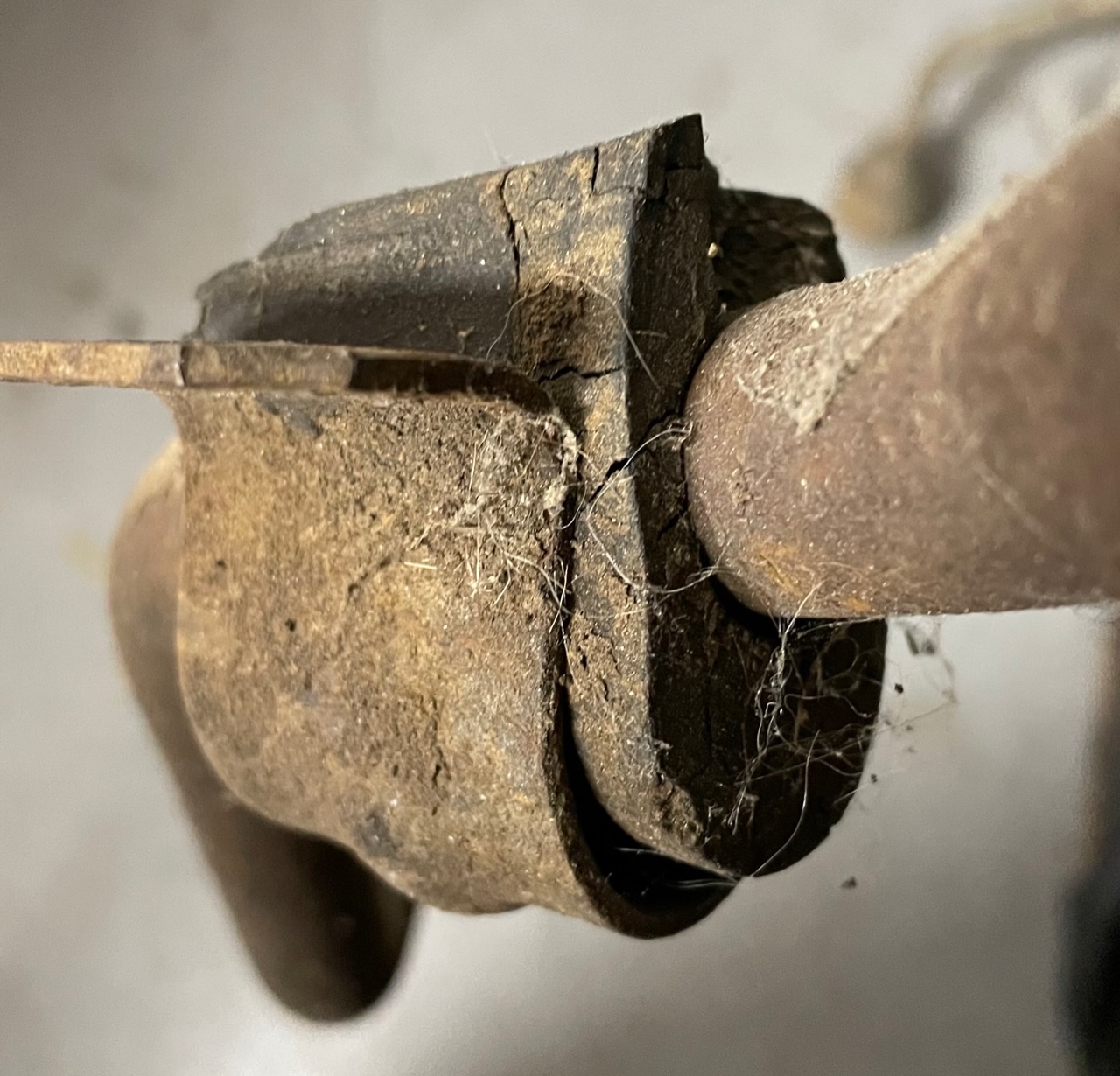

The stack of sway bars have the larger style rubber bushing used on a 1" bar, the molded edges can be seen in the pic.  On the factory installed handling package, which would have been take off, the rubber mounts were smooth on the side, like the smaller stock sway bar.

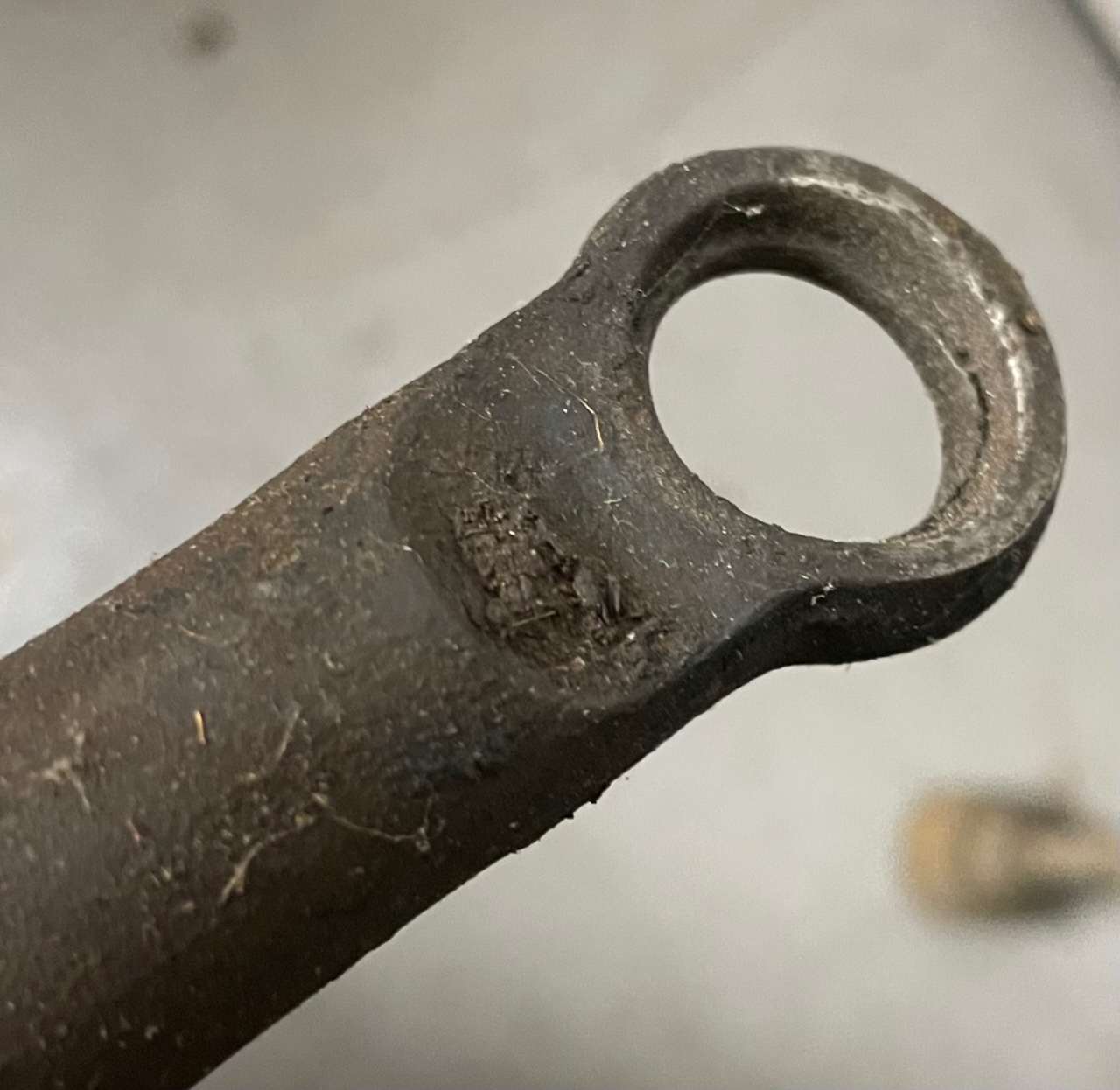

Here's a couple pics of the stock handling package sway bar...

As mentioned earlier, the Mustang sway bar to body mount never had that side edge molded on the bushing either, only the 1" had that.  That's what I was trying to show in that pic of the old Mustang sway bar, which is a 13/16" handling package (GT) sway bar.
I believe the end design of the 1" Shelby sway bar did change later.  65-66 and 67 sway bars were not the same dimensions also.

Thanks for posting the factory undercar photo:
- the sway bar appears smooth steel;
- the oil pan field fasteners (vice corner fasteners) are slotted pan-headed 1/4-20, with what looks like split lock washers;
-my car was issued w phillips pan headed 1/4-20 field fasteners with integral external star lock washers FWIW.

Yes, I noticed the oil pan fasteners before.  I'm guessing this is a very early prototype.  Don't think it is 003 though.

Back to my original post with the image of the stack of sway bars.  I don't agree that those are take-off bars, they look like 1" bars.  And the whole point of posting that is to show that there appears to be a shine to the bars, like they were painted.
The other pic I posted of underside is likely an early prototype, as noting slot screws for the oil pan... I'm not sure that comparing that car to other normal production cars would help what we're discussing.  Maybe it would have been best that I didn't post it.
