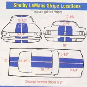

Hi All,   5s444 is finally ready to go to the paint shop for the Lemans stripes and the side stripes.  I have found in the 2019 edition of the 1965 registry the diagram on page 20 showing how the stripes taper.  However, the diagram is not as clear as I would like.  Is there a better diagram on the Forum, or at the SAAC website somewhere as I have searched and couldn't find any diagram.    Since the page 20 diagram is pretty clear on the overhead sketch, my questions are about the dimensions on the lower grill support, stone guard, and valance...  As well as the rear taillight panel and valance.    Any help with a better diagram or specifics would be appreciated, as I want to get this right the first time.  Thanks, and with my recent retirement, this project is well underway.  Mark

IIRC, this is what my painter used to paint my car. Maybe others can validate these dimensions or provide a better diagram.

Quote from: doublemyv on April 19, 2025, 02:22:45 PMHi All,  5s444 is finally ready to go to the paint shop for the Lemans stripes and the side stripes.  I have found in the 2019 edition of the 1965 registry the diagram on page 20 showing how the stripes taper.  However, the diagram is not as clear as I would like.  Is there a better diagram on the Forum, or at the SAAC website somewhere as I have searched and couldn't find any diagram. Since the page 20 diagram is pretty clear on the overhead sketch, my questions are about the dimensions on the lower grill support, stone guard, and valance...  As well as the rear taillight panel and valance.  Any help with a better diagram or specifics would be appreciated, as I want to get this right the first time.  Thanks, and with my recent retirement, this project is well underway.  Mark
Mark,
That diagram shows the front of the hood and valance are 9-1/4" so I assume everything in between is also 9-1/4". There's a mistake in the diagram, the lower right car is shown from the front but should be from the rear as those measurements are from the rear. The 2019 1966 Registry diagram also has this same error but all the other Registries I have show it correctly.

Thanks guys,  After much research, I think we have the definitive answer, and the diagrams in the 1997 Shelby American World Registry were helpful.    I did notice that the diagram in the later registry had the error in showing the front of the car twice.   So, here's my next question:  How much weight (lead shot ankle weight bags)
