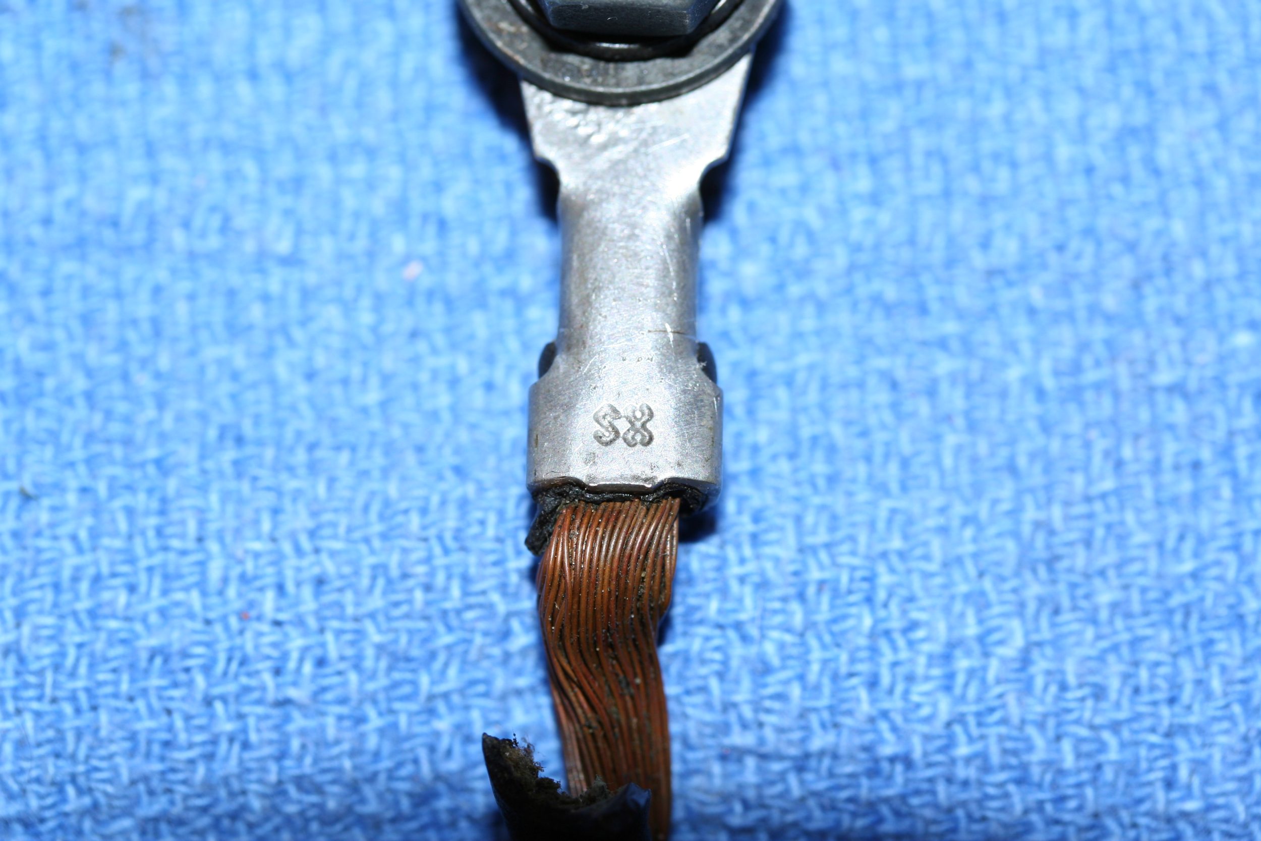

SX was a maker's mark logo for Essex Wire Corporation. The ink stamped SX is a plain text representation of the maker's logo printed or in some cases metal stamped somewhere on every electrical item Essex Wire made for Ford Motor Company in the mid-1960s
Note the artistic SX logo stamped into the Ford FDD-14303-A grounding cable assembly ring terminal.
I found this corporate logo online.
