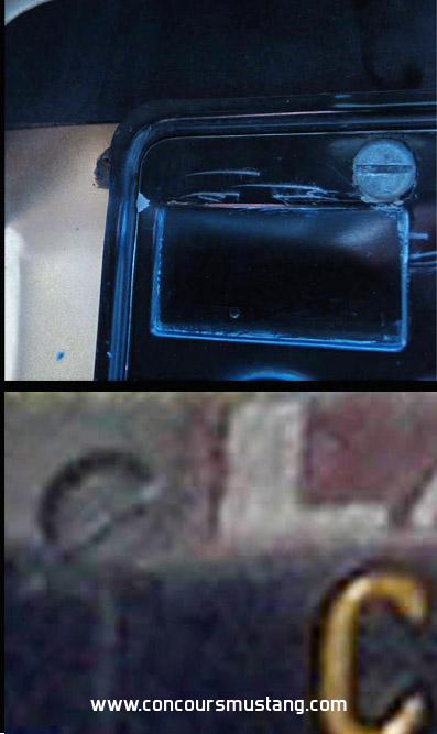

Thanks Royce. Are there any 67 GT350 period mag test articles showing the engine compartment? That should shed some light on this since there is a noticeable difference on how the filter sits in the air cleaner due to the different filter OD's.
The reason I'd like to figure this out is I have several 50+ year old aftermarket filters (photo below) with the smaller OD, I'm thinking of selling but need to dial in the correct application. They should at least be correct for Boss 302 and CJ, just not sure about 67 GT350.
TLea
Perfect, thanks Tim!
That filter looks to fill the cleaner assembly almost to the edge so is definitely the larger OD filter IMO...
