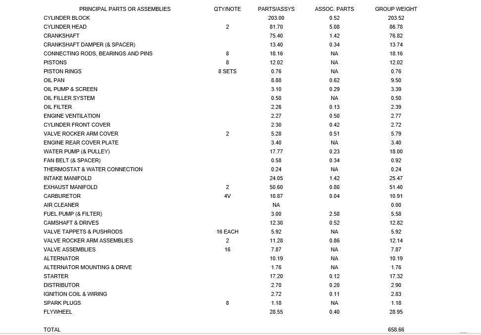

Anyone have a ballpark what a bare 428 block with a crank and damper on it would weigh? Breakdown even? Block, Crank? Thanks.

I put a 30 over 428 C scratch block on a scale years ago and as I recall I think it was 173 pounds. I didn't weigh the crank. A Cobra Jet intake was 74 pounds.
Royce Peterson
I shipped a bare 390 block a couple years ago. With a pallet, plumber's tape to secure it to the pallet, and wrapped in plastic the scale barely hit 200 pounds. A 428 should be a bit lighter with a bigger bore.
Quote from: 68stangcjfb on May 02, 2024, 09:02:50 AMI put a 30 over 428 C scratch block on a scale years ago and as I recall I think it was 173 pounds. I didn't weigh the crank. A Cobra Jet intake was 74 pounds.
Thanks. About 15 years ago I sold 2 CJ intakes on the 428CJ forum. a spring 68 date coded intake weighed 84 pounds double wrapped in cardboard. The spring 70 date coded intake wrapped exactly the same weighed 88 pounds. We got an engine on a stand we may have to lift off by hand and it is an almost bare block with the cam and crankshaft in it with the front damper and pulley still on.
Quote from: Royce Peterson on May 02, 2024, 11:38:22 AMI shipped a bare 390 block a couple years ago. With a pallet, plumber's tape to secure it to the pallet, and wrapped in plastic the scale barely hit 200 pounds. A 428 should be a bit lighter with a bigger bore.
Thanks Royce. Gary

Great chart, Pete.  So, cast iron 427 block and heads together = about 365 pounds.
Substituting aluminum for both items should shave off what...at least 100 pounds? Maybe little more?
That's what I've always figured.

Aluminum block weight drops down to about 160 pounds and the aluminum heads combined to around 55 pounds.
