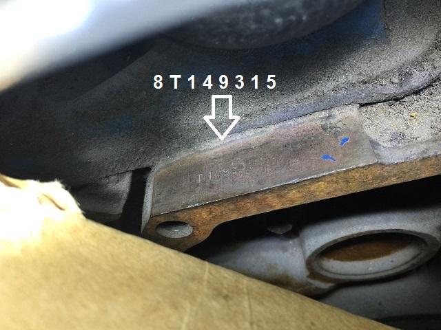

The derivative VIN should be on a pad behind the carburetor facing upward

Intake would be above numbers in photo
To clarify what Pete means, I think, It would be on the pad on top of the block just rearward of the rear edge of the intake manifold.

Pete posted photo of location while I was replying.

thank you i actually though it was further down behind.

Maybe the following will help others  locate the small block casting numbers and date as well as the VIN on a J code if some are still having a problem with locating each

Added some pictures to my post above
