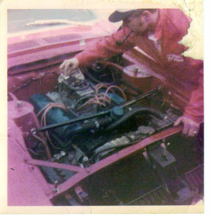

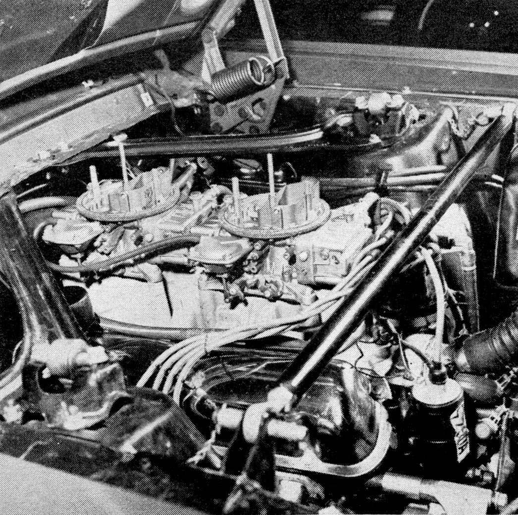

In the photo above, it is interesting that it appears the engine is not using the factory TA 2x4 intake but instead the over-the-counter 2x4 one.

Which photo are you referring to Roy - one of the BME Cougar photos I posted?

Here is a shot of the engine bay of Wayne Andrews' ex-BME Cougar.
Notice the slightly bent Monte Carlo bar. This is the type is what I have seen on many historically correct 67  68 vintage TA cars and not the silly one with the big hoop in the front of the distributor. That hoop compromises the structural integrity of the bar in a way that renders it a little better then being totally cosmetic. The straight bar is of course structurally the best but the slight bend minimizes any adverse structural effects of a less then straight bar.
This is likely the restored gurney  car that ross myers has . when it was found it had been reskinned as a 69 and had nascar style jack screws in front towers
Quote from: propayne on December 01, 2023, 09:19:08 AM
BME TA Cougar engine shot scanned from one of my magazines.
This is the daytona test car  that was rolled /  then sold for parts and was cut up to build the paul pettey  car .

Quote from: gt350shelb on December 01, 2023, 06:39:45 PM
Quote from: Bob Gaines on December 01, 2023, 11:11:34 AM
Quote from: propayne on December 01, 2023, 09:33:32 AM
Bud took his well sorted racing Cougars into the new NASCAR GT series and cleaned house, winning the '68 Championship with "Tiny" Lund driving.
I'm surprised that nobody has mentioned the Boss 302 engine that the car has in it. Unless I missed that comment.
      Roy
If it starts it's streetable.
Overkill is just enough.
by that time it was likely a nascar engine
TA Coupe
Quote from: propayne on December 01, 2023, 05:11:13 PM
Yes. It is an over the counter 2x4 intake because runners 2 and 3 are tall like the street one. I'm looking at the pictures on my phone so they may look different on a computer screen. Here's a picture of my street intake showing what I'm talking about. Also a picture of one of my TA intakes to show the difference.
