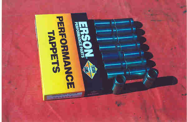

they also run shell lifters with longer pushrods
