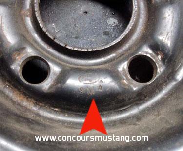

is this a lot number or does it contain a date code on my 69 GT350?

I talked to Keith(Musclecarman15) today. The wheels are date coded in the center of the wheel on a flat spot. EX 9MB where the "M" is for motor wheel.9 is year and B is Feb.  As of now nobody has figured out the date coding yet on space savor BF Goodrich tires.
Quote from: shelbymann1970 on December 08, 2023, 10:39:37 AM
..................The wheels are date coded in the center of the wheel on a flat spot. EX 9MB where the "M" is for motor wheel.9 is year and B is Feb. ...........
Example
Quote from: SCJSTU on November 26, 2023, 10:42:18 AM
that looks like the dot number

Keith said that nobody have figured the BF out yet. Also while tires started having DOT on the tires in 71 Space savor tires started showing up with DOT on them prior to 71. He has been dealing with SSs for LS6 Chevelles and  Mopars also.
