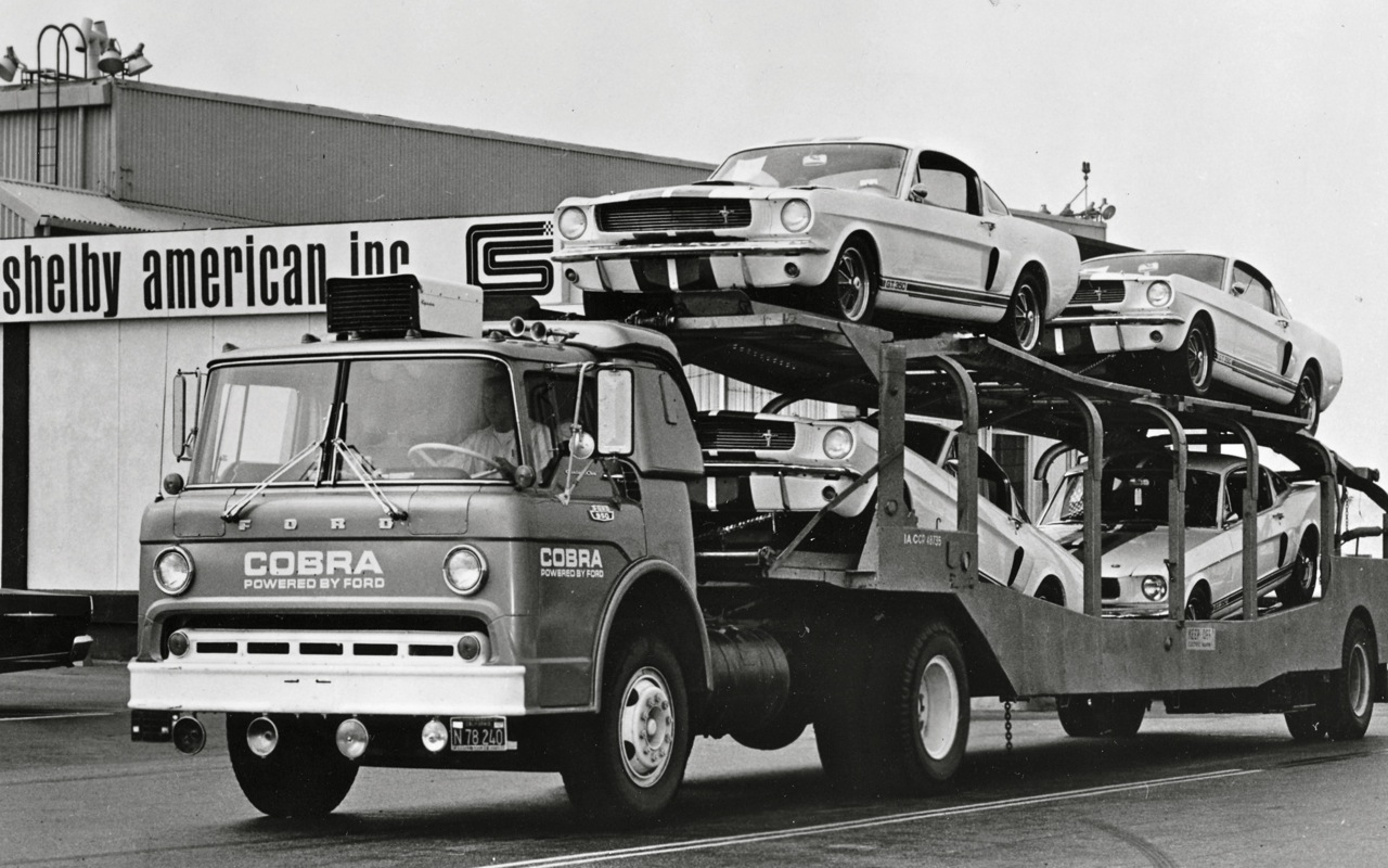

I remember reading this famous photo shows carryovers and was taken in Oct 1965, can anyone verify?
Have more examples from after carry over cars since so many of those have been restored So like S2MS I went to period pictures (except for one below) of what were or likely are carry overs since you seem to be more focused on those. Here are a couple. All below 6S400 for this set
And a couple of examples of right after the change over. Same workers and practices it appears
