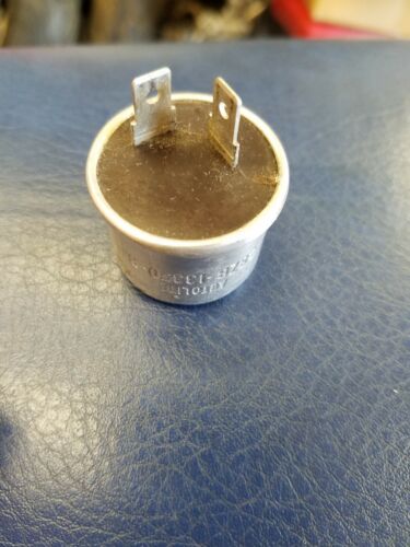

Didn't see the flasher canisters after took radio off?
It that it??
Thx
Paul
you are looking for two small canisters like this. They should be on each side of the opening, about the diameter of a quarter
1969shelbygt350
Found them! Thx snake!

Any quality auto parts store,  make sure you get the correct one not one that just looks like it
More than likely will have to be ordered
1969shelbygt350
#10
That will not work for the taillights and the auto parts store will not have the you one you need.
You need one specifically for the six bulb application.
They will swear it is correct, but trust me its not.
Quote from: 1969shelbygt350 on October 08, 2022, 01:04:03 PM
Ordered from NAPA auto store
Like I said looks the same but not,  you need a  323 flasher not a 552
Good luck
