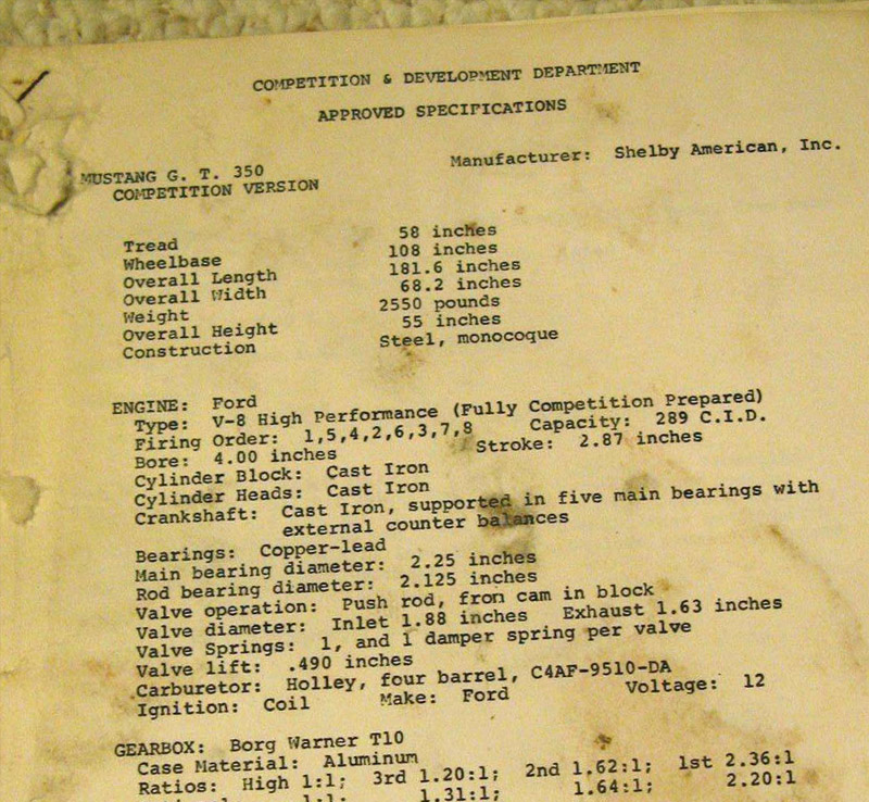

I found a document that looks like a shelby dealer package detail list. It only mentions valve lift at .490". I also just got an email back from Curt Vogt from cobra automotive, here is his reply:

Notice that the "official" list of the competition engines list not the part number of the cam or identifier but just the lift at .490 as shown below. Other later list of parts for comp engines list a fair number of different part numbers.

You have asked a question which may well be unanswerable, absent an authentic build sheet for a particular car for a particular race.
Agree that the C7FE went over the counter w a 1967 part number, but Don Sullivan profiles, of which the C7FE is one at 107, were used with differing phasing in years prior.

Camp upshur, good info! But i imagine the cams your are referring to were probably changed during testing, race season, development. My question was more towards this scenario: regular customer (spirited driver, weekend trackdays) walks in shelby american in 1965, wants to buy a gt350r, what camshaft is in that car "the basic GT350 competition version"
