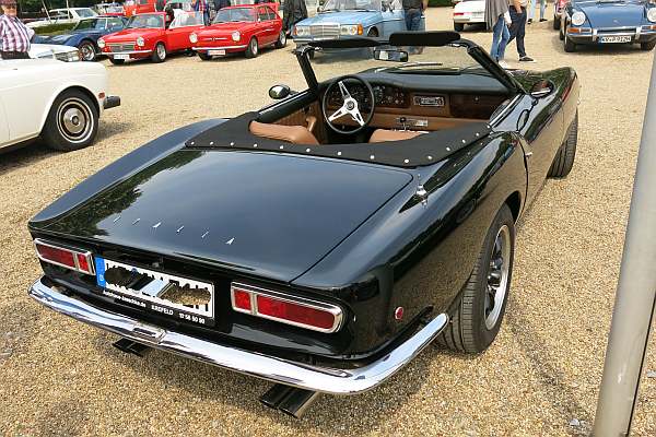

I invested about 2 years into finishing an italia  but it was pretty far from stock.
Side-Oilers
Very cool ride! Looks great in black too.

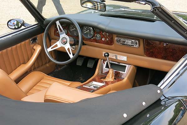

Harris Speedster
Very nice !!!
Is it a early 1968?
I ask because of the front engine aprons.
What wire wheels did you use?
The magnums that came in the cars are 66 Shelby, part numbers and all.
Your steering wheel, what brand, and did you have a BULL horn center made for it ?
I think Alex Trebec was involved in the headlight covers, and if you bought new molded windshield rubber, that was part of my handy work with Alex.
I asked him about working on his own Italia, he said he bought tools that he didn/t even know what they all were.
Funny, I asked him if you bust a knuckle open as car guys do, then what, he said stage make up John>>
I am going to stay stock, but may make a few>> tasteful mods as you have done. NICE !

car was  pretty bad off   it has a  street rod   front subframe and rack ........ whole nother story .Was suppose to be front steer kit  they sent  a rear steer subframe . .... was not  figured out untill it was welded in place and car was painted (great fun) and  a 9 inch  center section with independent rear . Alot of panels were reworked  and  modified .   dont remember where  wheel  or center came from  very possibly  fabricated .
