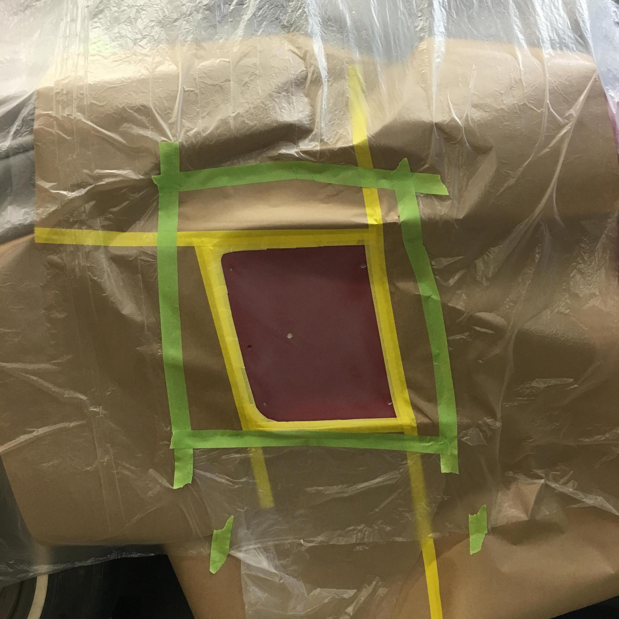

White convert I believe should be blacked out inside the scoop ? Just spray low-gloss black through front of scoop? Flat black? Want to be sure before I spray black where it would be difficult to remove  :o
Thanks for any tips

Rukiddin
Thanks! Tonites project and pinch weld black out will make a big difference....
Not sure why picture is turned.......

During installation mask with 3M automotive masking paint. Use  100% silicone.  install the scoop. Mask around the scoop on the body right to the edge without overlapping the side of the scoop. Mask the scoop side, to the very edge that goes against the body. Don't allow it over the edge that seats against the body. Take the scoop back off, apply the sealer to the scoop edge, put it against the body and do NOT slide it around. Get someone to tighten up the retaining nuts.  You'll need some cotton cloth/rags and 90% isopropyl alcohol. It will remove the excess silicone. It must be done while it is fresh and wet. In other words immediately after installation.
Allow it to dry. You can that juncture degrease the inside if the scoop and use a paint tack rag to remove dust and particles. I picked up automotive spray paint universal black for my 67 Shelby.  Do NOT use low-tack house masking products. You can use Frogtape, or 3M professional automotive products. Be sure to pull the tape off back over top of itself SLOWLY.  You should have complete success following those instructions.
Yes, back side of lower scoop was painted flat black. The factory installed clear silicon after the scoop was installed. A lot of newspaper and masking tape should do the job. You can tape right in the center of the flat part of the opening. It takes about then minutes. I do recommend getting some wax and grease remover if you should have any overspray. When you do the clear silicon, it was usually on the top and back, the front edge and bottom were not typically done.

If photo was taken with cell phone, will sometimes be turned.
I found that if you manually turn the photo on the cell phone 90* and click done, then go back and turn it the rest of the 270* then click done, when you post the photo, it will be correct.
I'm speaking for an iphone, don't know about others.
