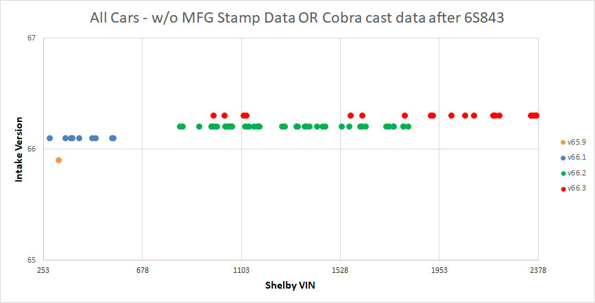

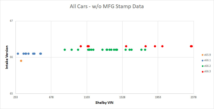

Finally had a chance to compile the info from forum 1.0 and the latest results. Jeff Speegle has also been researching this subject, his observations are included as well. Thanks to Jeff for sharing his info!
Changed the version combinations (chart below) to reflect what has actually been observed, plus changed the version numbers which made more sense to me when plotting in Excel. At this time only cars which had BOTH firing order location and Cobra casting style information were included. We decided not to include the manufacturer marking since it cannot be seen when installed and there were few cars with that info, plus only one car has reported having the Offenhauser stamp so far. As a result v66.4 is not listed on the graph plot, that one car is lumped in with v66.3 until we get more info. Also included early cars after 6S253 with original S1MS intakes (v65.9) but only one car has reported that.
We decided to not post individual VINs but if you reported your car's info you can easily see where it lies. If you don't have the original intake you can see what the cars around yours have...
This info certainly is not meant to draw conclusions what version intake individual cars should have, only to show the information gathered so far. Thanks to all who reported! Please continue to report original intake info! With more data we can get a much clearer picture of these versions throughout 66 production and hopefully fill in the gaps, there is still a pretty big gap between v66.1 and 66.2. I will continue to update the graph as more info is reported. Also, this could easily be expanded to include 65 and 67-68 intake differences. If anyone wants to take that ball and run with it let me know, I'll be glad to help.
Decided to also post this graph which adds cars without Cobra casting style information AFTER 6S843 with the assumption that cars after that are very unlikely to have the 2A casting style. This data fills the graph in more as a number of owners after 6S843 only reported firing order location. Anyone with an original intake that hasn't already reported please let me know oyur SAI VIN and I'll add it. Thanks!

According to the chart 6S20xx is most likely to have version 66.3.
Had a few more cars report since I originally posted the graph in Reply# 32 so updated that today. Also added another graph which adds cars WITHOUT Cobra casting style information AFTER 6S843 with the assumption that cars after that are very unlikely to have the 2A (square) casting style. This fills out the graph more using cars that only reported firing order location. Of course now an original 2A car after 843 will show up and blow that assumption to bits.
