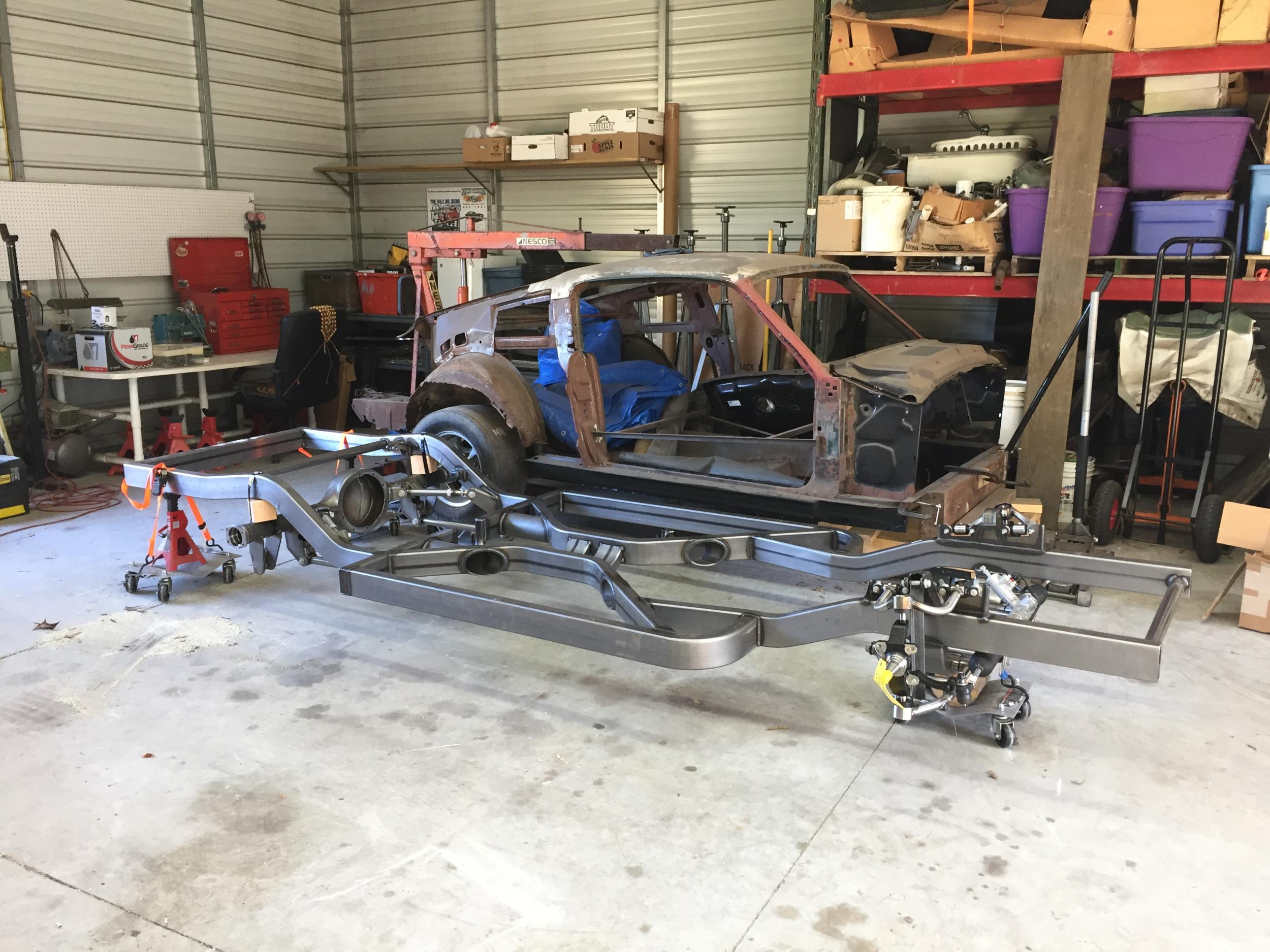

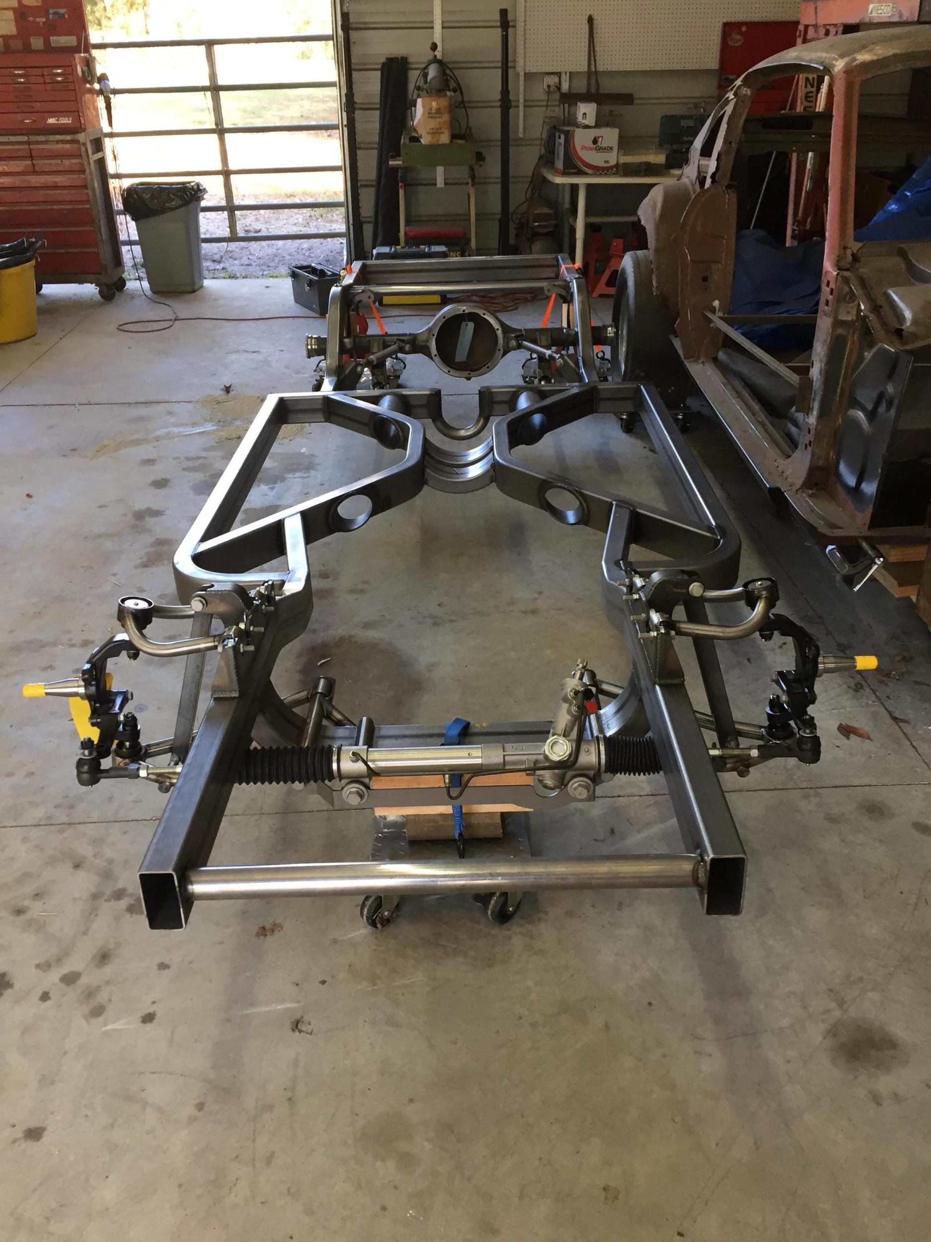

The new chassis arrived last week - now the fun begins!!

Hey, nice, new frame. Is that going to be heavier than the original style one? It'll be nice and stiff.

Snakebit - The AME frame is somewhat heavier than the equivalent stock Mustang parts, but I'm going to trim weight wherever I can. Thinking of doing Lexan side windows, aluminum fender aprons & floorpan to save a little weight. Dove is building me an aluminum 427 tunnel port so that will be considerably lighter than the original 390 and have an extra 300+ HP. I'd love to bring it in under 3100 lbs. but I do want to retain the fold down back seat, install a roll bar and Vintage Air heat & A/C so that may push it a little higher. I'm sticking with the original C6 mated up to a Gear Vendor's overdrive (more weight) with a 3.89 rear gear. Hopefully that's enough to move it down the road.  8)
