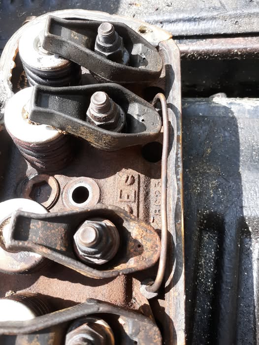

 any ideas what the E  in the casting stands for ? in same location where 289 / 302 would be
Arnt these the early small chamber casting for the 289 engine, often found in 1965-66 models?
roddster
so the 8G23 indicates the part was cast on July 23, 1968 (or potentially 1978)
the "E" in a Ford casting number generally indicates that the part belongs to the Engine engineering division
CSX4781
#4
Hey Phil,
  Since it's a 69 302 head, according to Bob Mannel's book, that E is just the suffix to the  whole casting number (C9OE-E). Hope this helps.
Quote from: CSX4781 on December 14, 2025, 02:24:00 PMHey Phil,
 ahh that  is  reasonable
roddster
  Yeah but WHO jumped on the 65-66 years?
Quote from: roddster on Today at 02:38:47 PMYeah but WHO jumped on the 65-66 years?
Some remedial education may be needed.........
https://www.fordification.com/tech/datecodes.htm
C90E: C9 = 1969 / -O = Fairlane (1962-68, Torino (1969-76), LTD II (1977-79), LN7 (1982-83) / E = Engine part
6049 = Part number for cylinder heads
E suffix = the 5th change level of that head.
