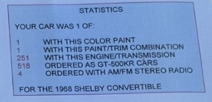

How to interpret Marti Report Statistics of this 68 Metuchen built J Code 4spd convertible:
Over 300K 68 Mustangs were built, do these statistics relate to the total cars produced? (775 AM/FM radios would be a rare option then)
Also, always thought the only "Stereo" system in 68 was for the 8Track radio? (report misstates radio as stereo?)
Were there any 68 Shelbys delivered with an AM/FM (mono or stereo) radio?
So the way I read that is "775" is for all 1968 convertibles. You also need fastbacks and coupes to come to a total.
It is extremely rare in a 1968 Shelby, but there were a few cars.
I believe both the AM/FM and 8 Tracks were considered "stereo"
ALSO, when you read the Stats, I assume the Numbers are for ALL Mustangs added together for that Year, not just the Shelby Mustangs BUT, when talking about the 1969 Shelby's, do those Stats include the 1970 Shelby Numbers as well?
What about the Stats for the 1970 Mustangs, do they also include the Stats for the 1970 Shelby's?
Quote from: Coralsnake on January 24, 2024, 02:13:34 PM
+1 in that 68 AM FM was stereo same goes for 69. 67 AM FM radio was mono which can make things confusing .
TransamEd
4701 AM/FM for all bodystyles of 68 Mustangs. (Source: Mustang by the Numbers from Kevin.)
Here's the Shelby convertibles, so if you add about the same for fastbacks, probably 8-10
