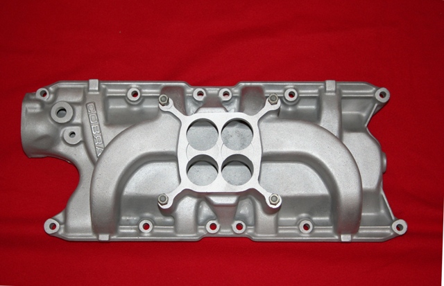

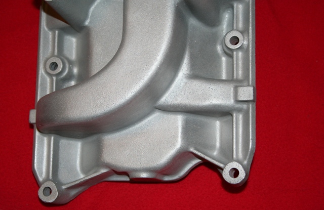

Is there a Hi-Rise version of the Cobra manifold without the pvc port?
#9
Quote from: csxsfm on December 19, 2023, 09:39:49 PM
The S1,S2 and S7 Cobra intakes were all called high rise. I have never heard of a factory Cobra intake taller. The MKI , MKII Cobra marked highrise intake did not have a port to be drilled. Some of the competition Cobra marked intakes that did have a pcv port were left undrilled.
Dan Case
#10
Yes. It was apparently not intended for street use because it had no provision of any kind for a PCV system fitting. It also had the fly cut reliefs between banks on the carburetor mounting flange as Shelby American did for the racing GT350 intakes later. All new Cobras with stock HP289 engines used PCV systems, even with optional 4V and 2-4V induction systems.
This version has very thin as cast port walls. They are fragile. I know I have located six of them and only two were not cracked at one of the carburetor fixing stud bosses, one still never installed and one still right where a dealer installed it in 1965.
The new unused one was ordered post delivery by a late 1964 Cobra buyer and never installed. We purchased the intake directly from that original owner.
The dealer installed one was ordered and installed in a 1965 Cobra during 1965. Without any provision for a PCV fitting the dealer installed a road draft tube for crankcase ventilation. As of early 2020 when I was examining it, it was still installed right where it was bolted down in 1965.
Dan Case

Quote from: Dan Case on December 20, 2023, 09:20:05 AM
Dan, are you saying a 289 Cobra should have an intake with the PCV port?
I believe I have one of the intakes you pictured above.  I'll send pics of it.
Mike C
'65 GT350, '67 GT500, '65 289 Cobra
Dan Case
#13
Quote from: SFM5S159 on December 20, 2023, 09:40:31 AM
Mike C
Yes. Ordinary street Cobras with High Performance 289 engines used positive crankcase ventilation systems. Ford manufactured the engines in Cleveland Ohio with PCV systems. (260 engines in Cobras used road draft tube crankcase ventilation.)
If somebody ordered a C4SA-9421 intake factory installed (C4SA9421 on part, S1CS-9421 in 1965 service parts list) and the Holley® R-2599 carburetor (Ford C3AE-9510-A) to go with it for use with a 1963½ engine, the Ford rear of intake manifold PCV equipment was moved to the aluminum intake. This intake model was available at factory installed until at least about September 1964 and maybe longer. CSX2486 was ordered with a low rise COBRA intake in September 1964 but the car was delivered with a stock iron intake so the $51.50 charged (which was the catalog price for a C4SA-9421 intake) was refunded along with a letter of apology.  There was no mention of an optional carburetor being ordered. That is the last mention I have come across of a new Cobra order for a factory installed "low rise" COBRA intake manifold.
1964-65 engines had PCV systems originating from a rocker arm covers but still had a hose connection behind their carburetors in the aluminum spacer installed between stock iron 4V intakes and carburetors.
When the 2-4V option was ordered factory installed mid-September 1963 onward, a custom PCV system for new Cobra was installed.
The C4SA-9421 intake manifold is a descendant of a prototype 1962 260 4V iron manifold by Ford Motor Company. Holman-Moody made a copy version for 260 engines in 1962 racing technology in aluminum with and without their logo cast into them. The C4SA-9421 COBRA and TIGER lettered versions were produced and Shelby American offered them for sale. It is a poor choice for a 289 c.i.d. engine with runner volumes intended for a 1962 style 260 c.i.d. engine.
The intake I show in Reply #10 is more mystery than we would wish as I have never found a Ford Motor Company or Shelby American reference that positively identifies it beyond doubt. I have studied them on and off for decades now. I had one that had been used in a Cobra and had the typical crack at a carburetor mounting stud. The casting was also more porous than I liked. The port runners were fairly small and their walls were cast thin.  The GT350 street and race versions of intake manifolds were in use before 1964 ended. GT350 street cars used PCV systems of course. These no PCV ones that have been cracked and or cracked and repaired not so well have been very hard to sell. I nearly gave the one I had away. Well repaired ones have also been slow movers because so far we have no proof any new Cobra left Shelby American with one factory installed and the lack of PCV port makes an issue for near stock cars still using a PCV system. (There were adapter Ford spacers back then with hose connection for a PCV system but that is another subject.)
CSX2497, CSX2553, and CSX2555 all got 1965 MUSTANG GT350 high rise intakes and carburetors AFTER 1965 MUSTANG GT350 production started. (I had the carburetor from CSX2555 for years.) One of the cut back door race roadsters, CSX2513, was retrofitted with a 4V induction system using one of the 1964 427 Ford carburetors for a while circa December 1964. Which intake casting they all got is a mystery. Offenhauser (ready to use), Buddy Barksdale (unmachined castings racers could finish as they wished), and Ford engineering (machined by DST) versions were all supplied through Shelby American as versions of 1965 COBRA high rise intake manifolds by April-May1965.
Dan Case
