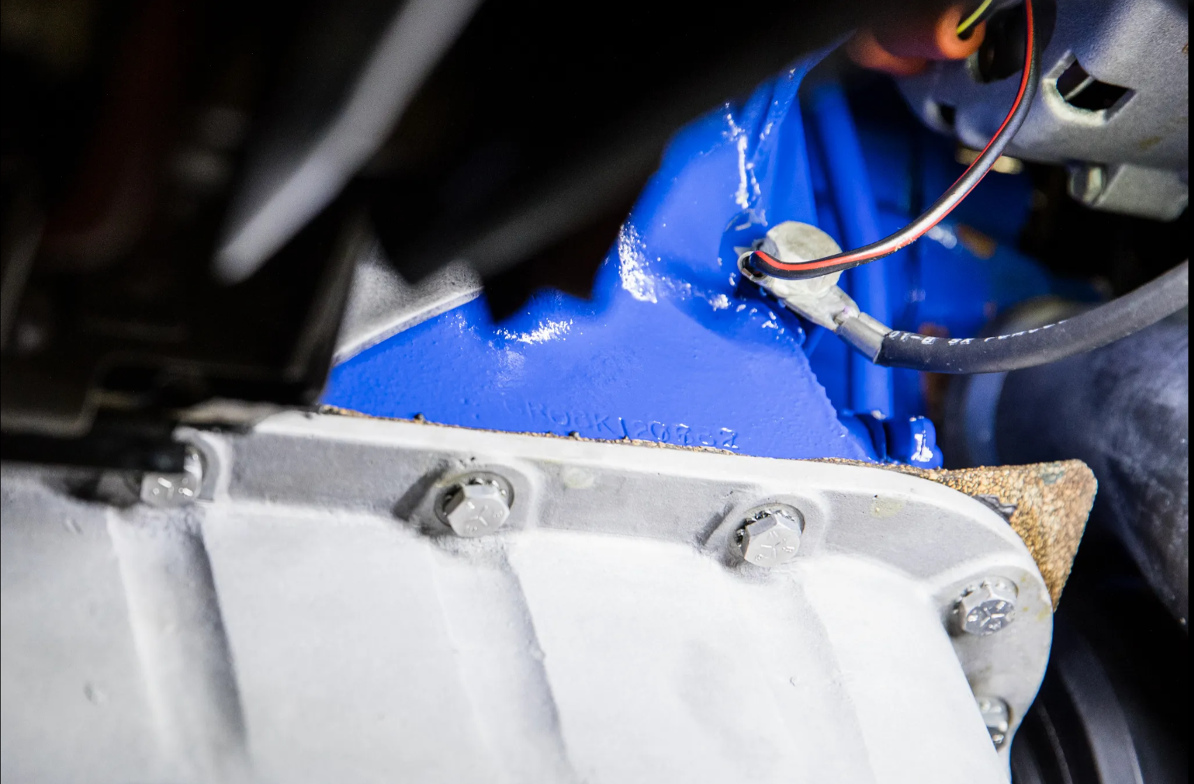

Mikelj5S230
Interesting, what do people think of Pardee's explanation of why the number do not match.....

As mentioned, it's uncommon for the wrong prefix for the body style to be stamped in the engine block, but I am aware of at least one other car where this happened. On that particular car, it was not corrected. The six digit number matches the Ford VIN on the car, the 6RxxK part is there as well, the "09" was just incorrectly stamped "07".
-Brant
Looks (based on the picture) that its more than a prefix number thing. The third, fourth and sixth digits are double stamped also.  Hopefully the seller will post assembly and casting dates also
Hope those bidding, as always look closely at the pictures provided and make their choices after they are fully informed/educated.
6s1640
I looked at this car when it was a bare shell at COBRA Automotive.  The three inner fender stampings were without error, correctly stamped 6R09K12XXXX, no double stamping.  The matching set of the sequence numbers are there on the block.
Cory
sfm5

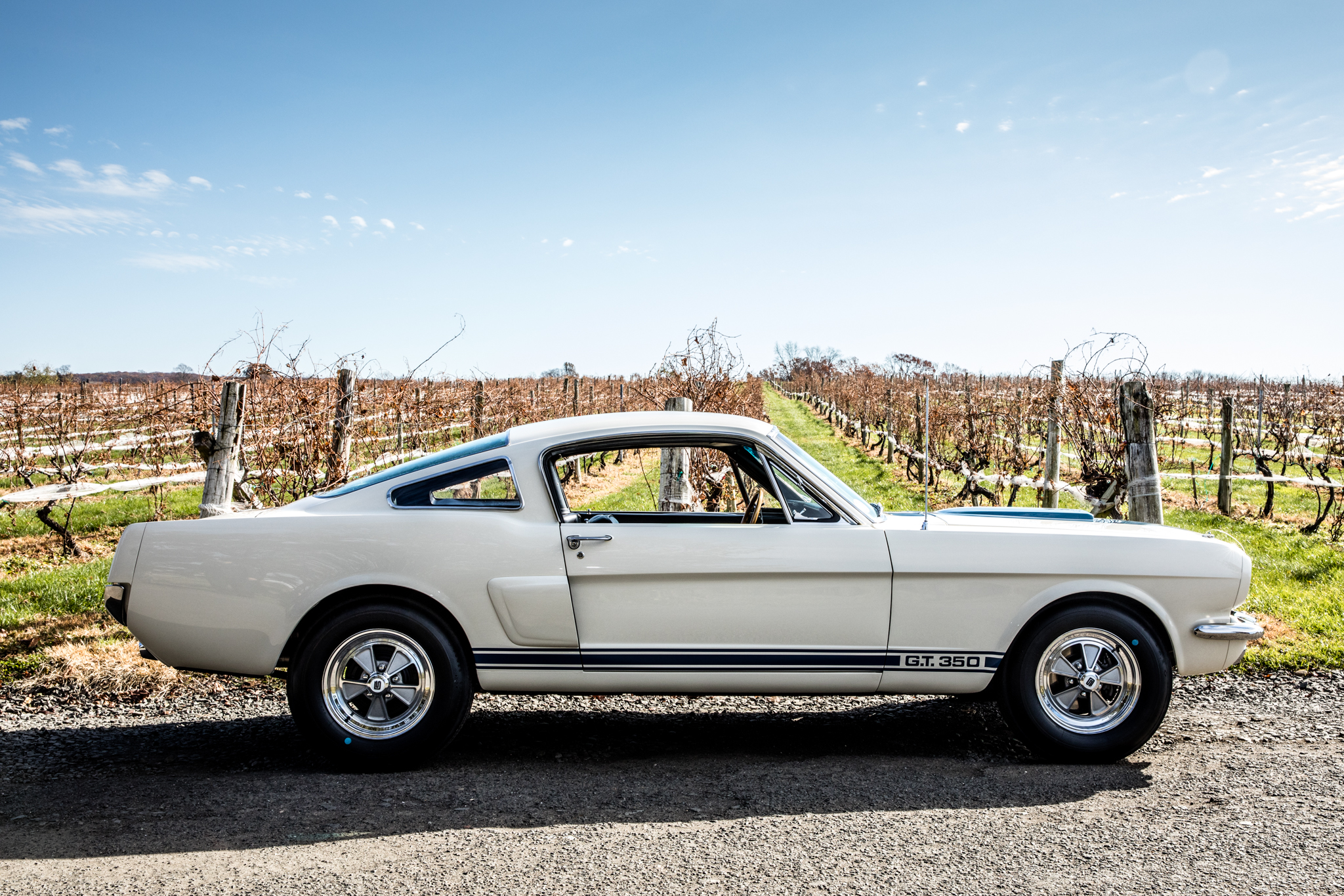

"The car is said to feature a 1965-style GT350 suspension setup with Koni shocks and override traction bars as well as upper control arms with lower mounting points compared to later 1966 models."
Given this, the car's stance appears to sit high with some rake. Most '65s I've seen (including my own) sit quite a bit lower with the tires inside the wheel wells and no appearance of rake. Can this be adjusted to owner preference?
65 GT350

I have a 68 Metuchen built 289 C code Mustang coupe with the same kind of Vin stamping error on the engine block ( prefix wrong, numbers match. ). S!*h happens.
Mikelj5S230
Yes, mistakes can and do happen. But to believe this is the original engine for the car, you have to believe that it happened to this car, without evidence, and then when you sell it you have to get someone else to believe it, again without evidence.
Quote from: sfm5 on December 05, 2023, 09:00:55 AM
Adjusted?  Not really but guess you could call it "adjusting". More modified things IMHO by replacing or modifying the springs or mounting points, coil over rear shocks and things like those. Or by the installation of new higher rate or worn or heated use springs.
Quote from: MikeljGT500HE on December 05, 2023, 10:05:37 AM
The mistake and the belief that it is legitimate is not much of a stretch for a informed Shelby enthusiast given other examples kept track of and documented by the Shelby registry. At least not much of a stretch compared to other marques that are less scrutinized.
6s1640
#13
Does the seller tell of the block casting and assembly date?  These should also be considered to support original block claim.
On the rear stance, it's likely the rear leaf springs were re-arced or replace.  I know Steve was looking for dated coded leaf springs, so I expect what's on the car is aftermarket.
Cory
Mikelj5S230
Yes, that casting and assembly date would be very helpful in this claim.  It will be interesting to see where the bid goes, maybe an informed Shelby enthusiast will buy it.
