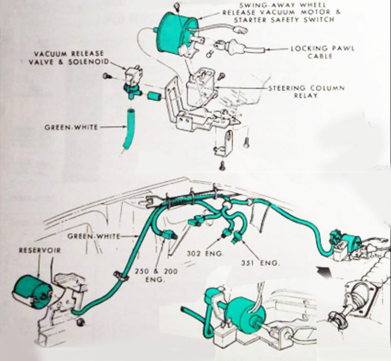

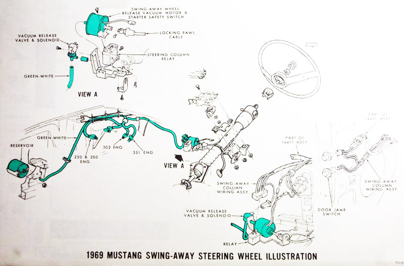

Can anyone provide photos for the routing of the tilt away column vacuum hose from the canister under the battery tray to the firewall? Thanks
Clear nice diagrams are included in the 69 Mustang electrical manual the oversized one at least I think there was. Will look to see if I have a scan
Hope these help
Original page
Composite

Thanks everyone for the reply's on this topic. I have ordered the hose from NPD as dead nuts on is out of stock. I have ordered the pieces from AMK and also a new vacuum canister. This should get me going. Does anyone know where the vacuum line from the canister goes as it makes its way under the shock tower bracing? I'm guessing a vacuum port on the back of the intake but not exactly sure. Thanks again for the assistance on this one, Bob
Quote from: 1970boss on March 08, 2022, 01:17:00 PM
The factory illustration posted shows it. If for a big block then it doesn't seem to be marked but it is the unmarked one with what looks like a double intake fitting in the illustration

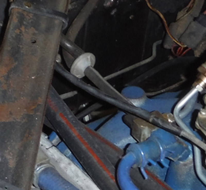

....................... Does anyone know where the vacuum line from the canister goes as it makes its way under the shock tower bracing? I'm guessing a vacuum port on the back of the intake but not exactly sure. Thanks again for the assistance on this one, Bob
70 but shows the connection point
1970boss
Jeff, thanks for the photo. Mine is a 70 so it's very helpful.
