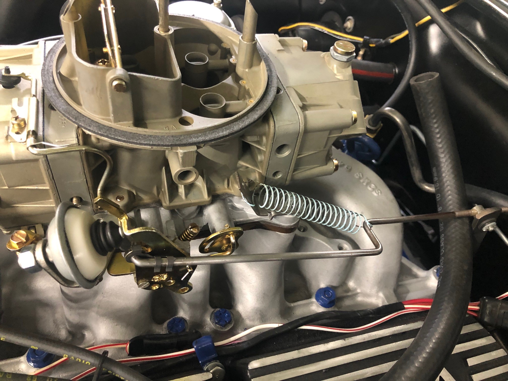

Corey Bowcutt
I sure wish I could post a picture of my setup.  It agrees with others that have sent me pictures for a 68 GT350 Holley setup.  But it is very different from the pictures shown of the dashpots mounted to the Holley carb specifically reply #20.
BTW I have lubricated my dashpot with no luck.  It slides in and out full travel pretty smoothly but clearly takes more force than my return spring provides.
Corey
Corey Bowcutt
With a little experimentation I was able to post a picture.  Not easy but at least it worked.
Corey

Royce Peterson
Looks like your application uses a C8 Autolite dash pot with the 600 CFM Holley carb.
The one in post #20 is the Holley dash pot you can buy right now from Holley. Not correct for your application.
The return spring and bracket should look like this if they are properly installed.
#39

Reading your post Royce "not right for your application" is that a ref to your pic(Holley)or his(autolite)? Is the throttle return spring available anywhere? Royce, is that return spring bracket at the base supposed to be "curved" up like that?
Royce Peterson
Corey's photo shows a Holley carburetor with an Autolite dash pot. The return spring bracket is available from Mansfield Mustang. Not sure which return spring Corey needs - it may be Shelby specific.

My friend's car has the original spring return bracket. It was bent like a rounded  open "C". I straightened it out with some pliers Charles mentioned that worked great but that pic in Royce's post shows the bottom part of the bracket being curved. Should it be straight like the pic below that was sent to me by another member a few months ago? Thanks.
68gtcoupe
The return spring and return spring bracket on Corey's car are both original and correct for his application.  The items were removed from an unmolested 1968 J-Code 302.
