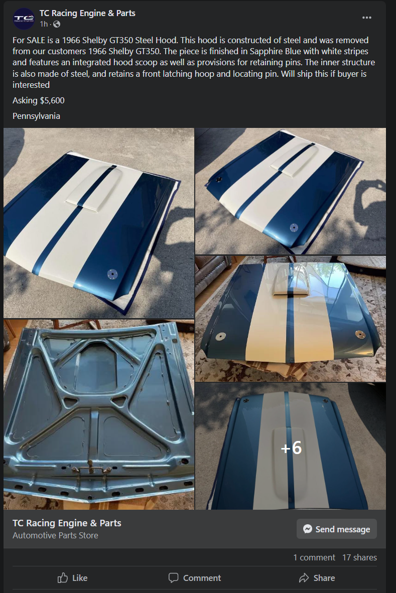

A company on Facebook is imposing this hood for sale for half the price as sold on Bring A Trailer.  Smells like a scam.  Using the same photos from BAT.
This Hood sold for $11,500 on BAT.  Honestly, is it really worth that?
Interesting that the hood pin plates are installed incorrectly . The plates are currently clocked like a 65 where the pin goes straight back between the rivets and not like a 66 where it goes at a 45 degree toward the scoop. That may seem trivial but it sends up a red flag to me. New plates happens frequently to replaced scratched up ones. Replacement isn't odd what is odd is why would you not use the existing original rivet holes which are drilled in the 12,3,6 and 9 position 66 pattern when replacing the hood pin plate? To me it indicates the strong possibility that the correct holes were never there . A made up hood may be perfectly fine if made properly . All the elements to make one are readily available to make one . The way the scoop was done for SA is the typical thing that is not followed when making a repro. I can't determine from the pictures any other original or non original tells . For that money I would want to know it is genuine or a reproduction. Of course because this public forum this information may quickly find its way back to the seller . No unused holes under the plate would indicate a repro. However he seller could take the plate off put a set 66 pattern holes in to cover the genuine aspect. There is no good reason IMO to drill 65 pin plate holes in a 66 hood like the picture shows now.
