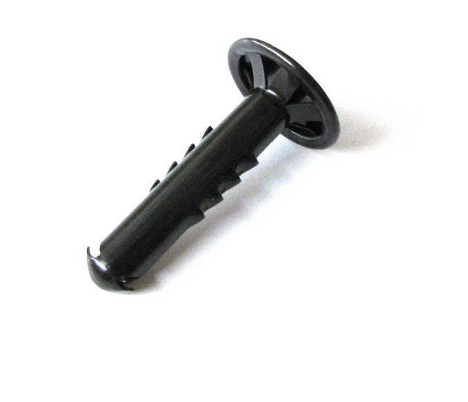

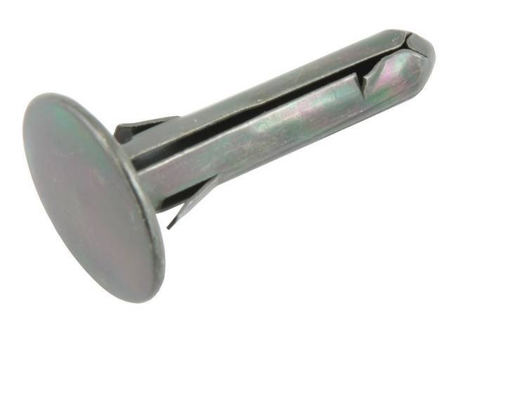

Jeff, thanks but can you say which style is the correct "post" style for the '66 San Jose GT350 cars.
The two choices offered are "dual tang" and "saw tooth".
As his are missing - which would be the more correct purchase?

Thanks for the pictures since I was think of a different "saw tooth version"
To be completely correct neither is exactly like the ones I just removed from a Spring 66 San Jose example. Good thing is that once installed you will really not see much other than the head from the interior side and maybe the tip (1/4" - 3/8") on the engine compartment side
Here is a close up of one I just took out for the picture no cut or tang at the tip as shown in the top example you posted. Only two very slight bumps. You may be able to see it right at the seam shown in the picture at about firewall depth
