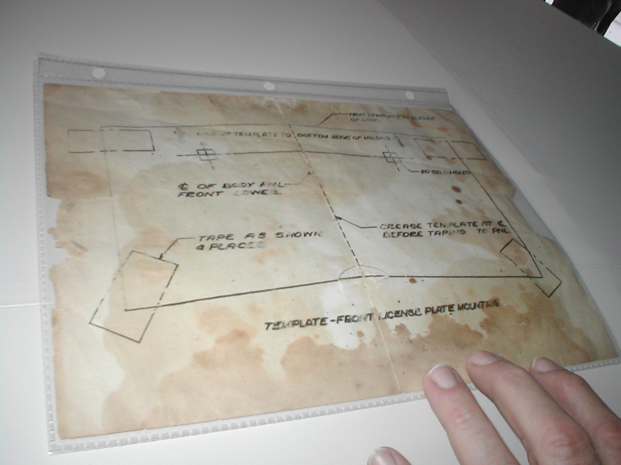

I need to add a front license plate to my car due to provincial regulations. Would someone have the template/and location for the plate holder that would have come in the glove box when new?

Thanks. I have the bracket already. It's the location where it's mounted info I'm looking for.

I could not find my photocopy, but here is an original.
You have to cut two square holes for the push nuts. The distance apart is the same as the holes on the bracket.
Almostthere
Bingo! Exactly what I was looking for! Thank you!!!
